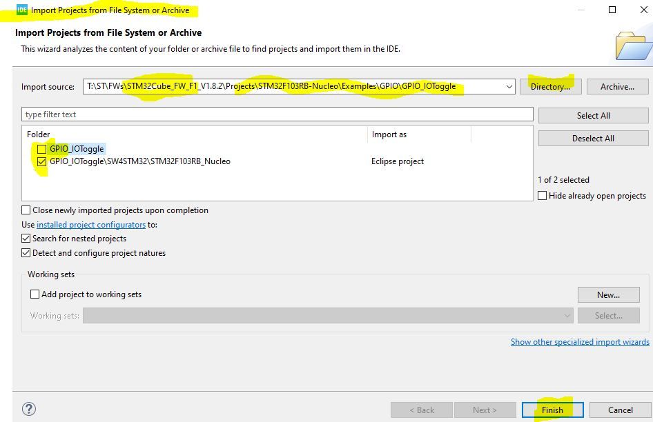

File > Import ...
Or File > Open Projects From File System even easier ...

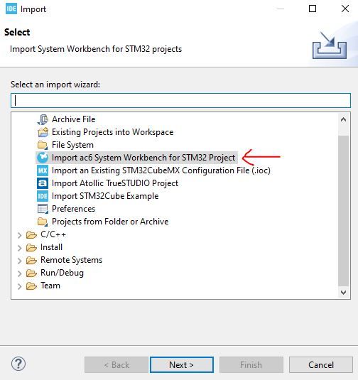

Thank you so much for your help. It indeed works if you import using the two methods you described as long as you create a new workspace for every example project. My problem was that I kept trying to import using "Existing Projects into Workspace" and "Import STM32Cube Example". Those certainly don't work. Thanks again!

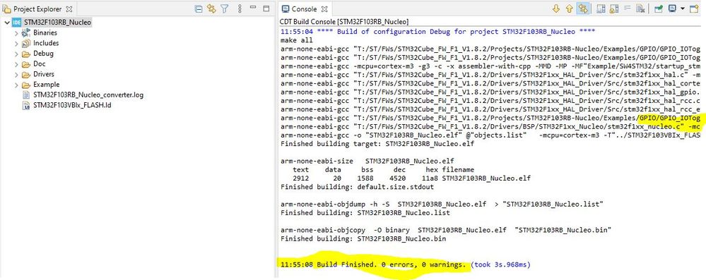

Here I agree. 2 examples cannot be imported within same workspace but not IDE issue ... STM32Cube example one. Most of examples (old series in fact sounds ST has done some progress here if new ones) are packaged a way which is definitively not so nice. It's a pain.

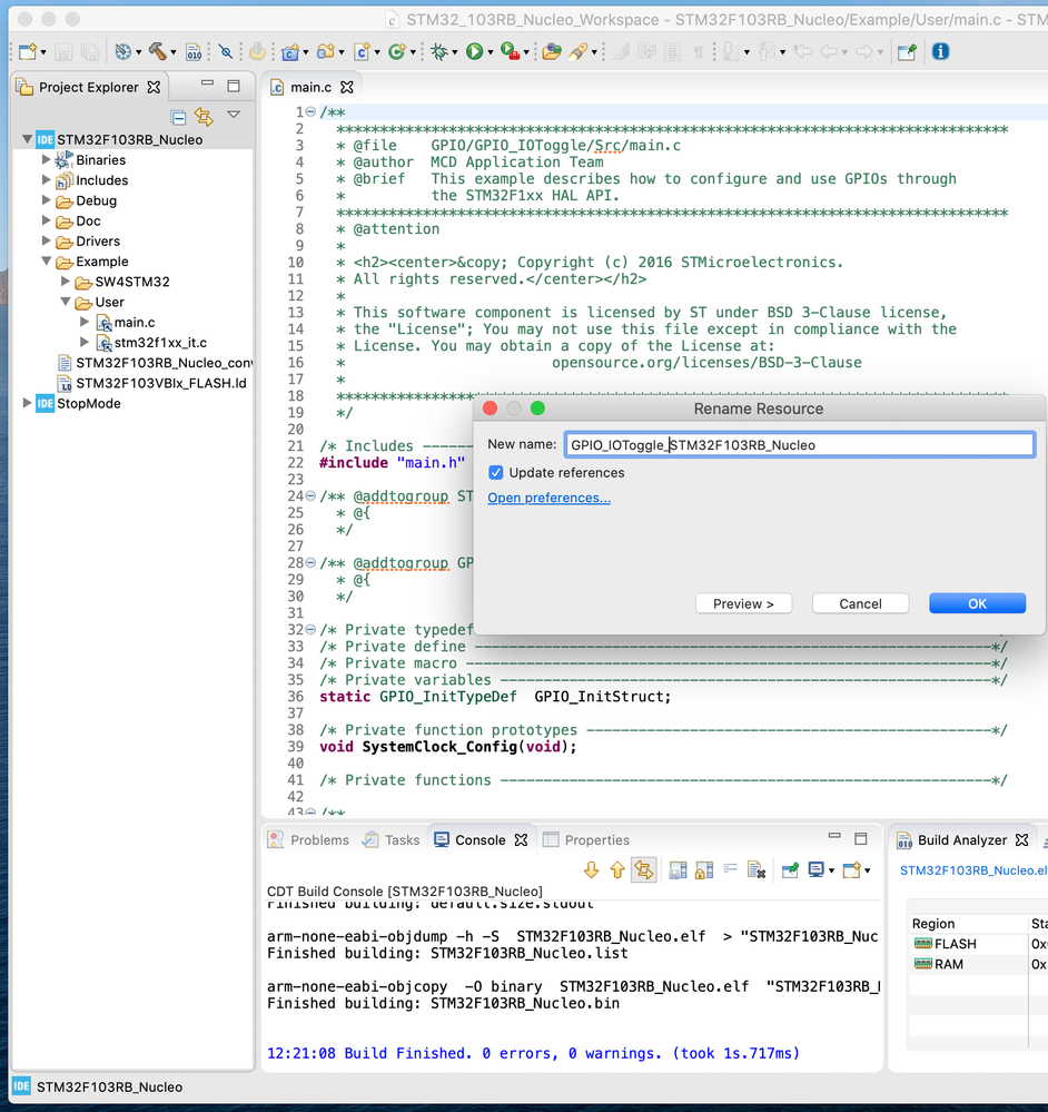

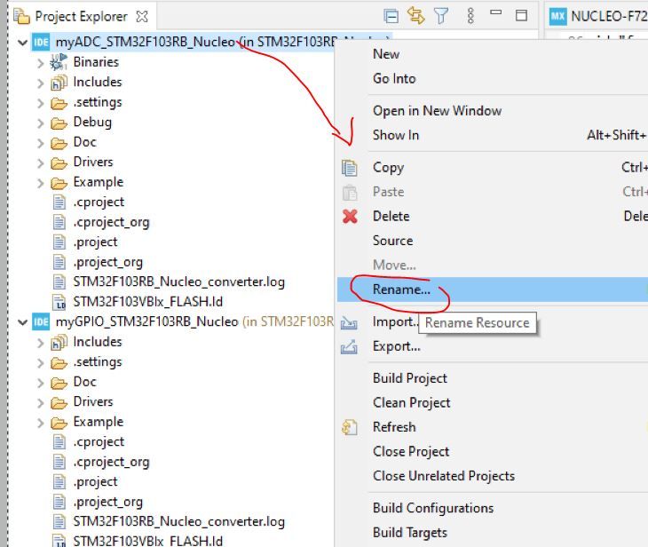

Good news is renaming on such old series is quite smooth. Once you have imported your project, have a try to rename it doing project entry root selection within your Project Explorer view. "Rename" contextual menu is doing the job.
Here i've x2 F1 projects imported from examples.

Please proceed renaming thru UI as shared above. Renaming from file system is doable but need to takes care to some metadata.

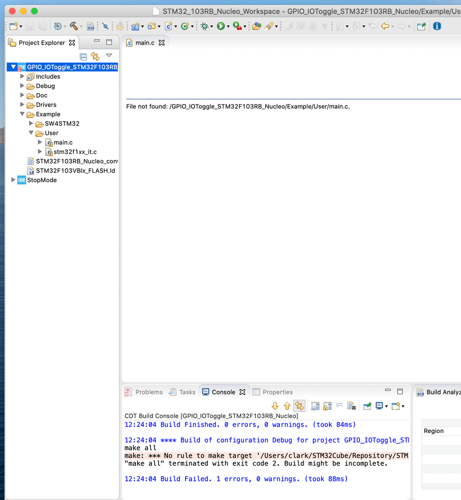

Yes, that is what I did. It appears the rename is successful. But when I clean and build, it won't build. Does yours build ok?

Yes clean then build is ok.

Mine doesn't. See if you can see what I am doing differently...
I selected the project, then rename, than I changed the project name. It appeared to work. But when I build it can't find main.c and make all failed. We must be doing something different when we rename....

Sounds weird to have lost sources. Such explain build failure but why resources move away ?
Could you share result of right click on main.c file within project tree view asking for properties ?
