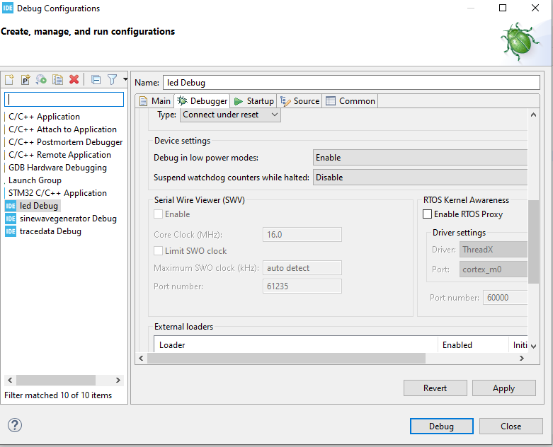

I am trying to use SWV viewer but in Debugger option, there is no SWV options available. Is it because of some faulty pin configuration? Because i ran a blink led program and it's working fine. Just the SWV, i cannot enable.

Hello @RShre.2 and welcome to the Community :)
SWV options is not available and not work with Cortex-M0.
Imen
