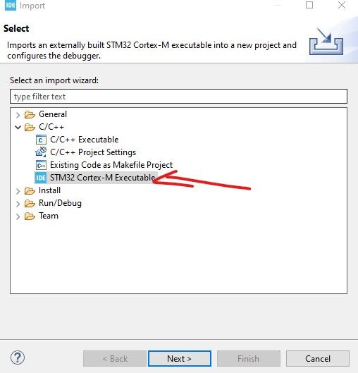

2021-12-17 6:34 AM
Even better File > Import > STM32 Cortex M executable
2021-12-17 6:53 AM
Absolutely true! Definitely the easiest way to solve the problem posed in the question.
My problem was a little different - I wanted to also be able to build my project via my own makefile using the STM32CubeIDE. Hence the new project creation in my answer. But I'm VERY glad someone else answered this as well - it took way too long for me to determine the solution.
