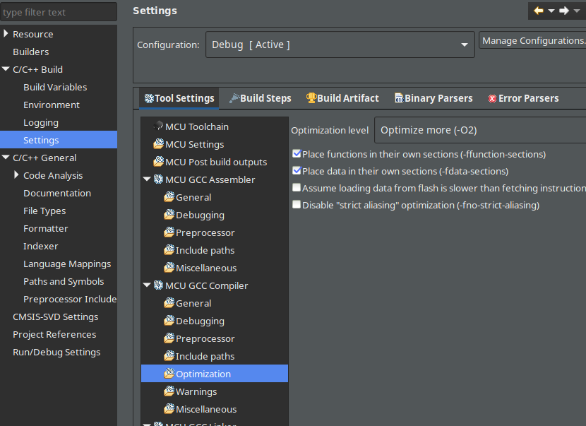

2022-12-12 1:55 PM
just make right setting for compiler:
and set optimizer:
report.

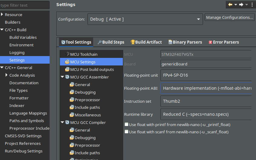

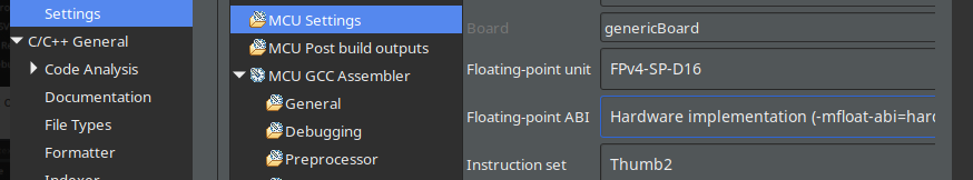

2022-12-13 12:14 PM
did you set this:
because "fpu not present" = you did not set this.
the fpu is always "active". the question is: makes your setting the compiler use fpu-code or not ?
