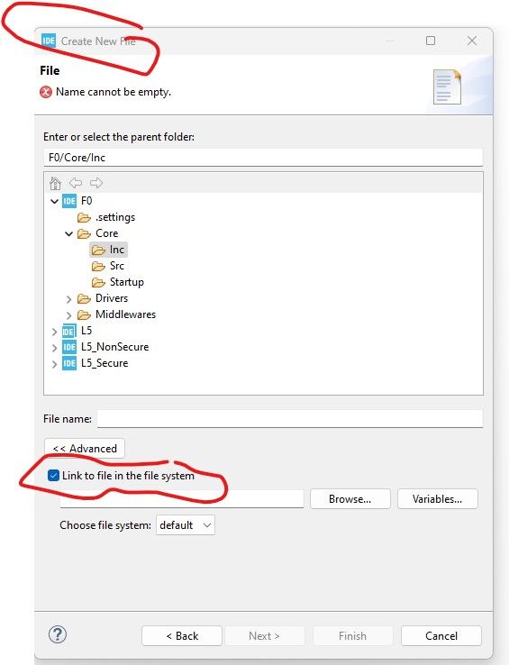

No choice .ioc file at the same level as the .project and .cproject are located is a MUST HAVE no other option. As extra restriction .ioc file name has to be same than parent project name.
Such said you can link .ioc file as far as link is at the same level as the .project and .cproject are located. Claiming link I'm discussing about Eclipse link style ... so called linked resources.
If GUI way to create a link is File > New > Others then General > File then rely on advanced settings to check Link to File in the file system option
