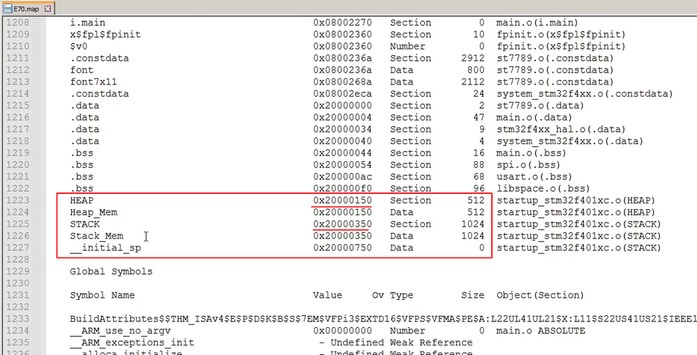

2024-01-26 7:08 AM
In Keil, if you open a file with the extension .map, you can find information about starting address of stack and so on. See screen.
How can I determine the starting address of the stack in CubeIDE?

In the Keil builds the initial stack is set to __initial_sp, and descends too Stack_Mem

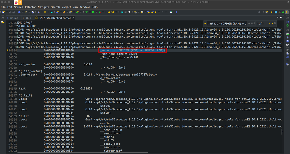

Go to STM32CubeIDE\Debug and open .map file. Try to find the line
_estack = (ORIGIN (RAM) + LENGTH (RAM))
2024-01-26 7:48 AM
Thanks for the answer!
I found the desired line in .map file
and I don’t understand what to do with it. See screen.

Thank you, but how to find out the end address of stack from this file?
2024-01-26 8:18 AM
_estack defines the end of the Stack which is the Top of the stack.
So normally the stack starts at: _estack - _Min_Stack_Size
