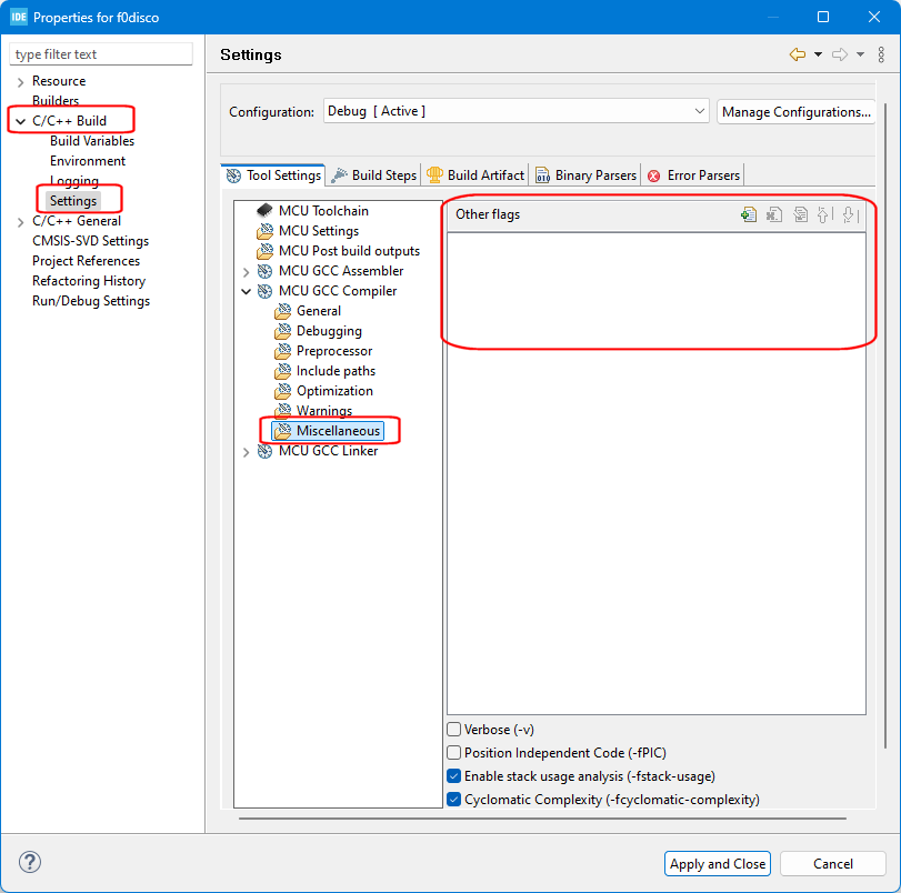

In general, you can add any arbitrary options here:
2024-11-27 1:19 AM - edited 2024-11-27 1:21 AM

Do you have any idea how to set this option because if I only wrote [-Wenum-conversion] in the other flags of the miscellaneous, i have the result:
arm-none-eabi-gcc: warning: [-Wenum-conversion]: linker input file unused because linking not done
