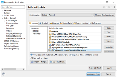

I have gotten this to work, but one of the files I have linked to my project is an include file. When I try to make the project I get an error saying that the .h file does not exist. I tried adding a path to the project as seen in the following screen capture, but it appears that the compiler is not taking the file link. How can this be resolved?
2025-03-17 2:27 PM
I discovered the solution. You need to select File System instead of Workspace when creating the path
