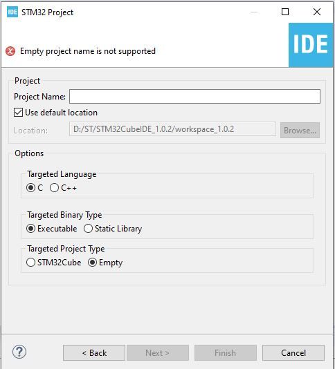

Ok, I've tried to do as you said. I've created an empty project in this way:
After, for the code, I clicked File -> Import -> Archive file. I can see correctly the code in the project explorer, but, when I build the project, I receive 10 errors. What am I wrong?
2020-10-07 9:11 AM
I don't know your code, I don't know the error messages, so I cannot anser your question, sorry.
