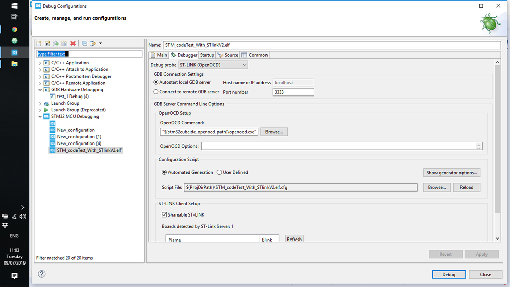

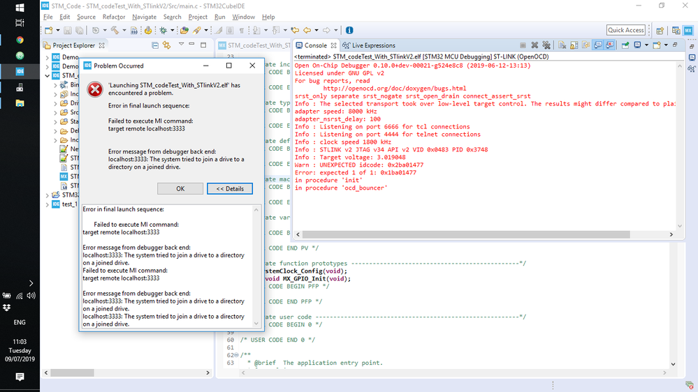

Judging from your error message, this might be helpful: https://mcuoneclipse.com/2016/04/13/fix-for-gdb-and-the-system-tried-to-join-a-drive-to-a-directory-on-a-joined-drive/
2019-07-09 4:16 AM

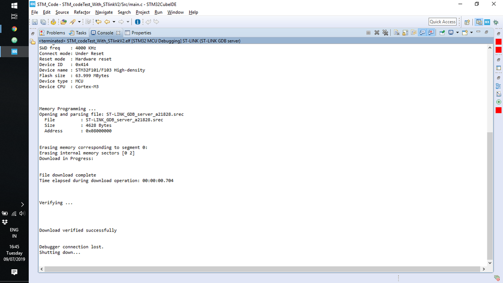

@Community member thanks for your reply, I got my problem solved. The problem was we have been using clone chip CSK one's but when I used another company st chips it worked in GDB server mode.

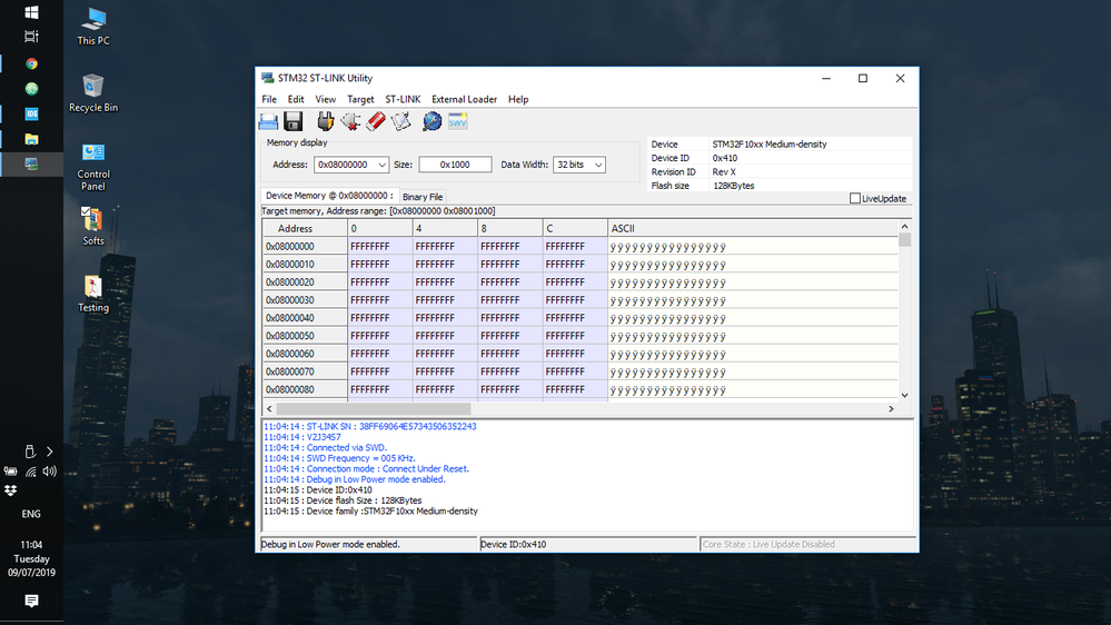

>>clone chip CSK
The ST-LINK or the STM32? Can you provide a picture or a cite so we can understand what you're talking about, especially if it is a local/regional thing.
2019-07-10 4:06 PM
CS32F103C8T6
CKS not CSK
2019-07-10 4:13 PM
LOL! ok at least it wasn't marked ST :)
