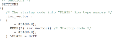

within the STM32 Cube IDE After creating a hex file, I noticed that some lines had less data than others due to linker separation. How can I use the STM32 Cube IDE to add dummy bytes to the memory?

There is no way that a file is changed by a tool! As I said before, you need to check which section ends at 0x800017C and use ALIGN to make sure it fits there!
2024-07-16 11:44 PM
Yes, it worked. Thank you.
The dummy bytes are replaced with 0xFF when >FLASH = 0xFF and with 0xFF when = 0xFF.
