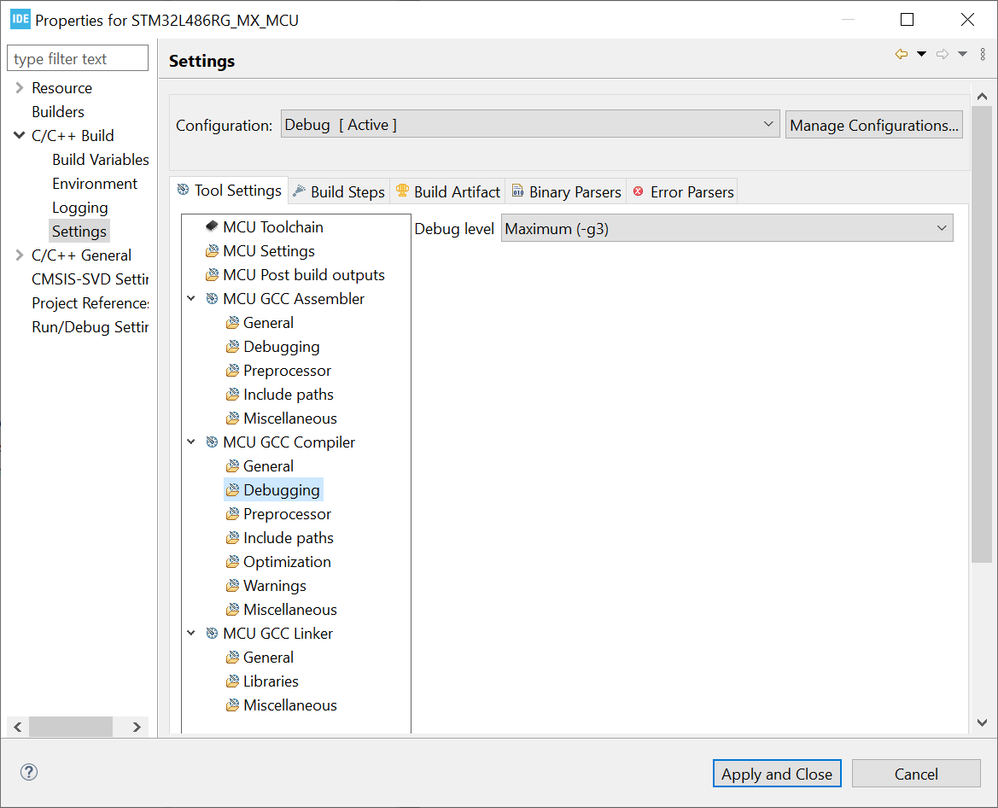

What is the Debug level set on the compiler?
