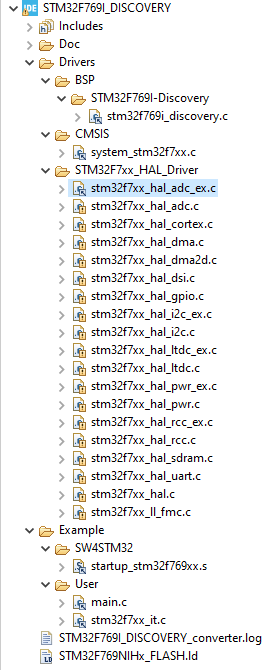

Let me introduce the situation. I download STM32CubeIDE from st.com, also the STM32Cube MCU package for STM32F7 series which provides many demonstrations.
The demonstration's project is created by three toolchains and they are EWARM ,MDK-ARM and SW4STM32. Can I open the projects file in STM32CubeIDE?
When I try to open SW4STM32 project in CubeIDE, the message says:
Project: STM32F769I_DISCOVERY
Converter: ST System Workbench for STM32 project converter
Date: 20201112
Unknown value type "" for id gnu.c.link.option.libs on tool fr.ac6.managedbuild.tool.gnu.cross.c.linker
Unknown value type "" for id gnu.c.link.option.paths on tool fr.ac6.managedbuild.tool.gnu.cross.c.linker
Option fr.ac6.managedbuild.tool.gnu.cross.cpp.linker.noexceptions is no longer supported
Option fr.ac6.managedbuild.tool.gnu.cross.cpp.linker.nortti is no longer supported
I have no idea on if the warning affect?
should I change to SW4STM32?

2020-11-12 2:06 AM
Unfortunately, following the doc. UM2579: Migration guide from SW4STM32 to STM32CubeIDE, the importing process fails.
you can see some source files cannot be located. I try to change one file's searching path through "properties" -> "Resource" -> "Location" -> "Edit"-> navigate the right location of the source file, the yellow warning icon before the source file disappear. But, there are so many source files with yellow icon. Also, it is not allowed to "edit" the path variable.
The reason may be that the fixed structure of the "STM32Cube MCU software package". Once you copy some parts to another folder, it fails to find the other parts of the package.
However, directly open the SW4STM32 project file, there is no such issue. "Build All" succeed, too.:smiling_face_with_smiling_eyes:

2020-11-12 6:33 PM
Finally, I found this:
https://wiki.st.com/stm32mcu/wiki/STM32StepByStep:Step1_Tools_installation
5 Launch STM32CubeIDE in debug mode and run my first program
In this section, STM32CubeIDE open the project file created by SW4STM32 directly and using the converter the SW4STM32 project file is converted to a STM32CubeIDE project file. I debug the example application successfully.
