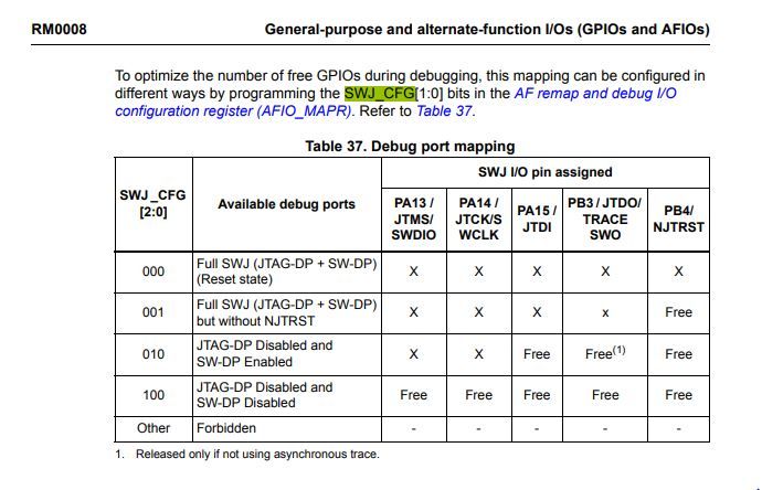

Hello @MMORA.3 ,
You can refer to the reference manual RM0008, in 'General-purpose and alternate-function I/Os (GPIOs and AFIOs)' and 'JTAG/SWD alternate function remapping' section.
PB3 is TDO/SWO, make sure to check how the JTAG-DP / SWD-DP mapping is set up on the STM32F1 parts, and check also DBGMCU_CR.
