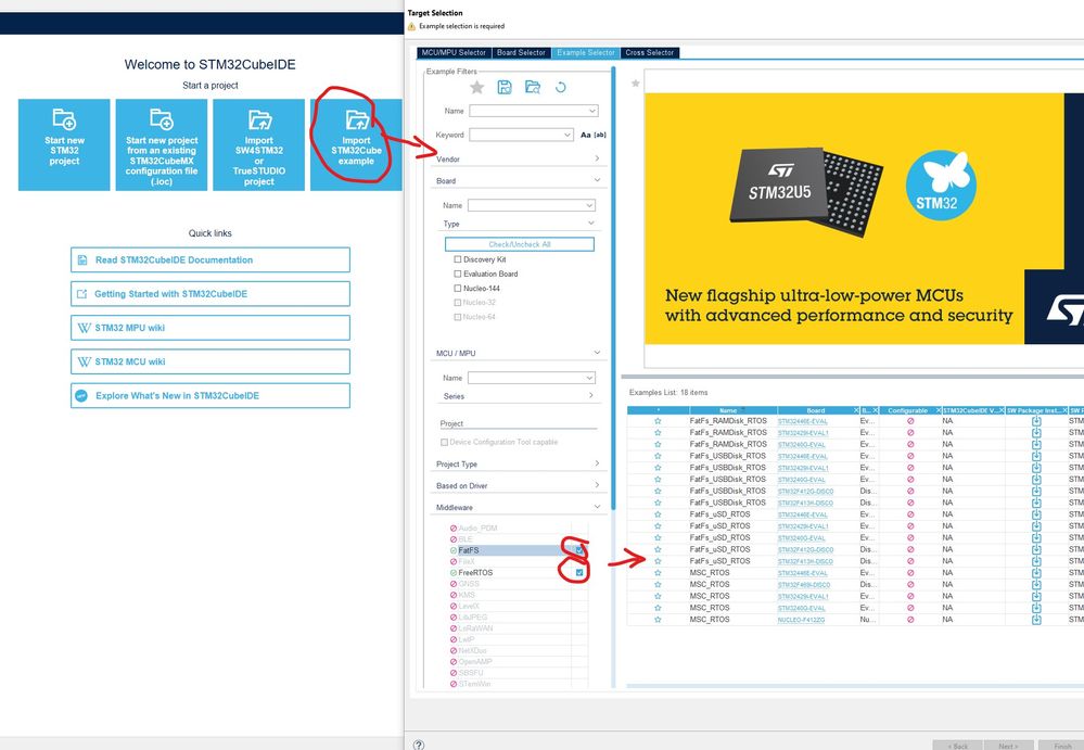

Even easier ... let's rely on example browsing import and feature ...
Either from welcome page or from File > Import > General > Import STM32Cube Example

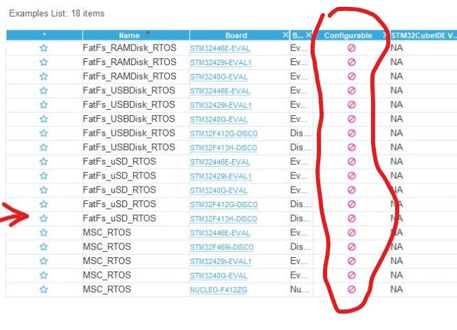

2021-04-27 1:28 PM
Unfortunately sounds no example supporting configuration
