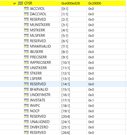

The value of CFSR is as follows.
I tried setting 0x20001364 directly to the PC register from the debugger, and it works as expected.
Is there a problem with the above method of shifting the execution?

Its THUMB code, add ONE to the address to make it ODD

I set MAIN_ADDR to 0x20001365(0x20001364 + 1), and the program works as expected !
Thank you for your support !
