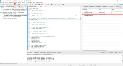

2023-09-25 2:13 PM - edited 2023-09-25 3:02 PM
Thanks for the answer. From the test I did, if I run the debug run(Resume) and put HAL_CAN_GetTxMailboxesFreeLevel in the live expression it gives this error
If I remove it from live expression to run (Resume) it works normally
Why does this happen is it a bug?

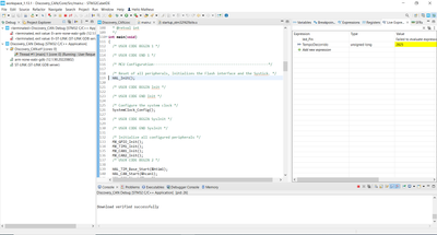

2023-09-26 1:36 PM
It seems like that's right, create a global variable being the function and it didn't give that error when reading the expression
