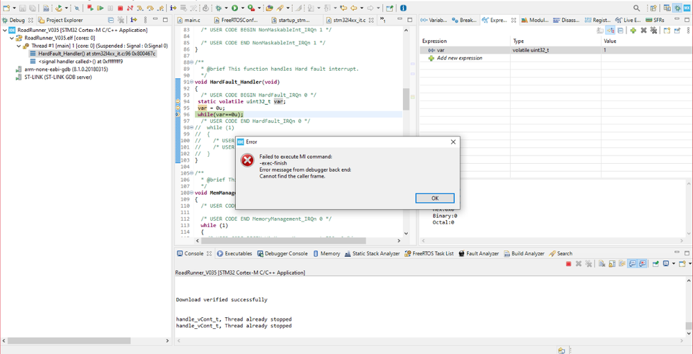

https://www.segger.com/downloads/application-notes/AN00016 shown in the above picture, I changed the variable 'var' to 1 in runtime in expression window in the stm32cubeide to find the root cause of hard fault handler while stepping out of the breakpoint which I set in the line number 96 in the code.

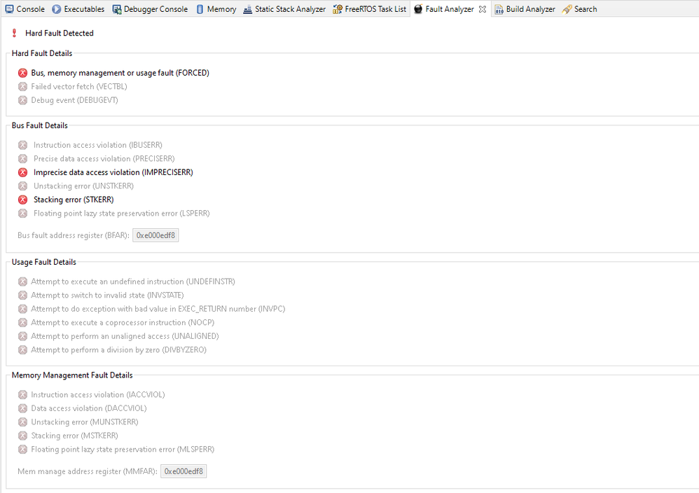

I checked the fault analyzer also and here I attached fault analyzer window
I am not getting where could be the issue? Please can anybody help me out?

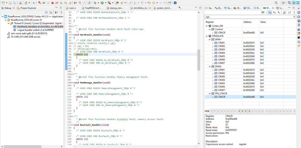

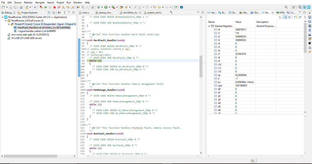

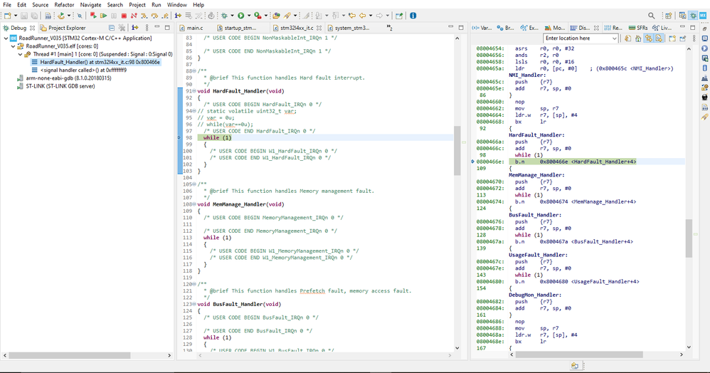

I tried as you told. I did step the coding from Reset_Handler. I set a breakpoint at where SystemInit() is called (in the startup.s) and while stepping into the function, the control goes to hard fault handler. I am attaching the snippet of disassembly, Registers and SFRs tab in stm32cubeide.
Still I am unable to solve the issue. can you help me please?
