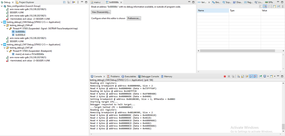

Hi @F.Belaid I followed all the steps but it did not help. Sometimes the error "Could not verity ST device" come and sometimes the M4 core gets stuck in another error "break at address 0x... with no debug information ..."
Image attached showing error
