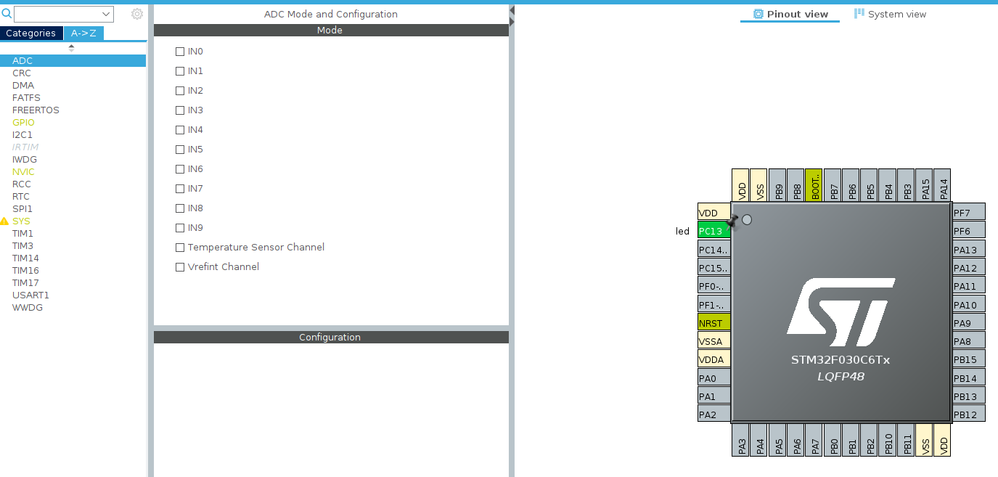

About the i2c library, In the project generation with CubeMX (which is included in CubeIDE) I only activated the GPIO (with LL), NVIC and SYS (default) peripherals (see attachment). So according to KnarfB's answer I should only have the .c/h files drivers corresponding to those three peripherals (+ dependencies), but I have some drivers in the directory tree which I find hard to believe are required like I2c lib, see attachment (but maybe they are actually required for non-obvious reasons so I should do a deep check of the libraries).
When you said regardless you mean that wether or not the HAL GPIO library (for instance) needs the LL GPIO library CubeMX will copy both of them anyway ?

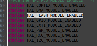

Interesting. I don't have an explanation for why I2C is being brought in. Is HAL_I2C_MODULE_ENABLED defined in stm32f0xx_hal_conf.h? Just curious. There are bugs in CubeMX so I wouldn't spend a lot of time on it. Or, as you said, maybe there are non-obvious reasons for why they're included. You could delete the file and see if you get compiler/linker errors.
What I meant was that CubeMX will only bring in what's necessary. For example in your code, it doesn't bring in the LL TIM library because the HAL TIM library doesn't need it.

I just checked and yes, the HAL_I2C_MODULE_ENABLED is defined in stm32f0xx_hal_conf.h. What if I want to use the LL and HAL libraries but the CubeMX doesn't bring the LL lib because the HAL lib doesn't need it ? I just can't or should I manually bring the HAL lib myself ?
And I just thought for a bit, but if CubeMX bring everything that's necessary, and that some HAL lib need LL lib (but not the opposite), why does it still bring the HAL lib when selecting LL (even if HAL needs LL for this peripheral, HAL isn't necessary in the first place since I asked for LL) ?
Oh and I just tried to comment the #define HAL_I2C_MODULE_ENABLED and deleted all i2c files, and everything compiles fine. Quite strange.

I would not recommend spending time to figure out why. It may change anyway with the next update.
RCC = root core complex which is used for setting up the on-chip clocks PWR = power management etc..
The linker will remove all unused stuff.
You can debug step through the code to find out which components are used.
Or, check the .map file whats really in your executable. STM32CubeIDE Build Analyzer View is a GUI frontend for that.
