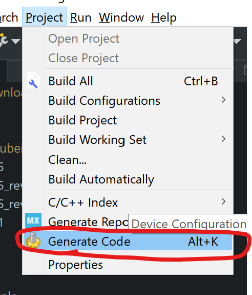

Double click the .IOC file in the project.

> which is the CubeMX perspective, no?
> CubeMX is the pinout and timing graphical setup, yes?
Correct on both points. CubeMX is a standalone program but they've integrated it into STM32CubeIDE for convenience.
> under Code Generator i am getting only the code generator page
> with no button or page to actually generate code.
After editing the pinout or making other changes, save the IOC file (File -> Save). Then select Project -> Generate Code from the menu to regenerate the code.
You can also right click the IOC file to regenerate code.

your original response was just the thing and gives a firm place to start.
