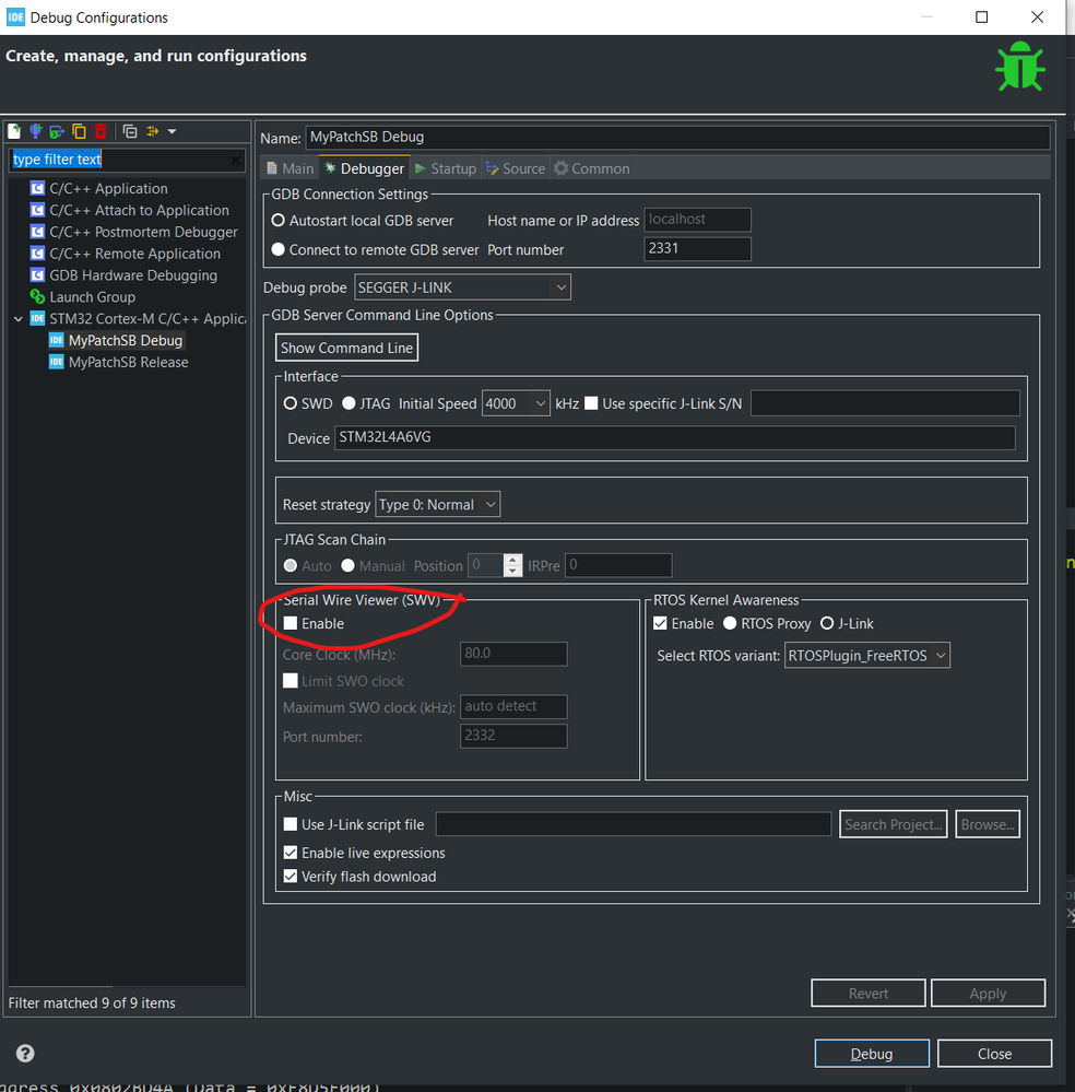

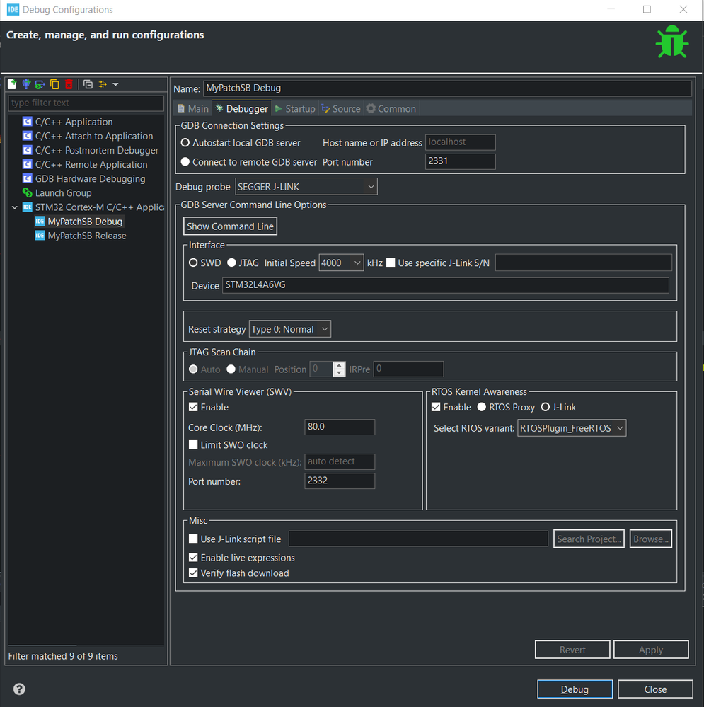

I was previously using 1.5.1 and it was working fine, but after upgrade to 1.8.0, it's no longer working. I'm using a Segger J-Link. My Debug setting are in the picture below. This is for the device shown in the settings.
2021-12-15 8:59 PM
I may have accidently found the answer. Not sure why, but disabling the SWV (Serial Wire Viewer) seems to fix the issue:

Me and one of the developers made a test with the J-Link RTOS with and without the SWV feature enabled but we were not able to see any issues.
Could you please explain what you mean by "Breaks", what exactly is it that stops working?
Furthermore, could you try to create a new debug configuration from scratch to see if it changes the behavior in any way?
2021-12-21 12:47 PM
I think the post is very clear with what "breaks". The thread aware aspect of the debugger is not working correctly. Your number 2.
As explained, I've tried different configurations on several different projects. Sometimes it works and sometimes it doesn't. As stated from TBuls, if you change the debug configuration, it will work for one or more sessions, but then stops working again. So I go back and forth between enabling and disabling SWV.

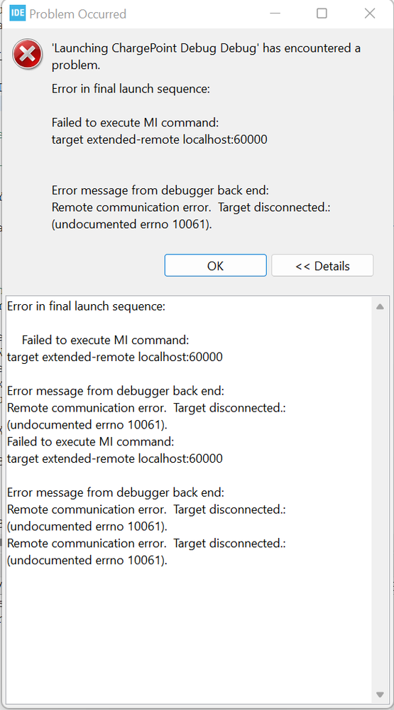

A also cant get kernel aware debugging working. I have working debugging, SWV works (but is disabled). When I try enable kernel aware debugger settings, I get the message below when trying to start debugging:
Using STM32H753, ST-Link V3, FreeRTOS. Anybody have any ideas how to get this working?
