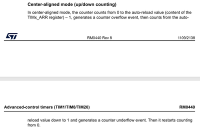

2025-01-20 4:36 AM
Dear Javier,
Thanks.
We are not able to explain the value of ARR based on the description given in reference manual. Can you please help explaining this?
Looking forward for your reply. Based on above text, ARR should not be 16,999.
Regards,
Srinath
2025-01-20 4:56 AM
Seems like you answered yourself, then do ARR=17000/2 -1.
the easiest way to check is to run some code and hook up an oscilloscope
