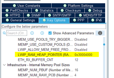

There is a bug in the new cube ide version in the lwip vonfiguration for the STM32F7
LWIP_RAM_HEAP_POINTER (RAM Heap Pointer) 0x30004000
There is no such RAM location in the STM32F7. the correct value should be zero but better u guys check it.
by the way this option was not there for the F7 LWIP Key options settings in the previous cube ide version.

I confirm that there is a mismatch between the address value in the comment and the actual address.
*----- Default Value for F7/H7 devices: 0x30044000 -----*/ #define LWIP_RAM_HEAP_POINTER 0x30004000

New since 6.13 in `lwipopts.h`:
/*----- Default Value for F7/H7 devices: 0x30044000 -----*/

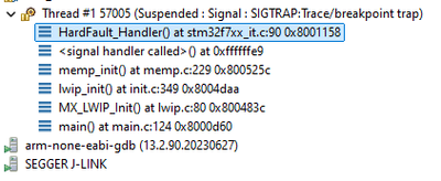

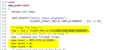

First I don't know why the value in the comment doesn't match with the actual value, second with these two extra lines generated, it breaks my program as in `MX_LWIP_INIT()` would not return. I guess OP isn't wrong.

I wrote it worng, default value for F7 /H7, the funny thing is no such location in the internal RAM for F7 and thats why it break with u same as with me.

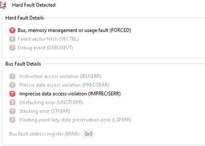

I am encountering the same issue. The STM32CubeIDE 1.16.x project runs ok, but the migration to 1.17.x causes the hard fault exception.
I do not wonder because there has been introduced (in 1.17.x) a new macro
If the .ioc code is generated, this value is added to the lwipopts.h. The ref. manual for STM32F746 is saying that the address 0x30004000 is reserved and probably no heap is there.
I no wonder that the hard fault is generated because of accessing reserved memory
I only migrated project from 1.16 to 1.17, regenerated the code and built.
