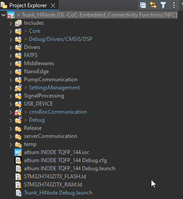

Here is the project structure:
The folder that does not have project settings is "cmsBoxConfiguration", which has the "key" symbol. Folder with the blue C symbol have same properties than the project.
Is sometinh wrong with the project configuration ?
