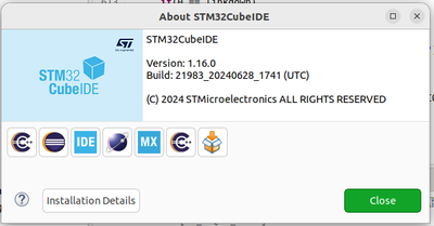

2024-10-02 12:46 AM - edited 2024-10-02 1:15 AM
The issue is still in 1.16.0 and also in 1.16.1
