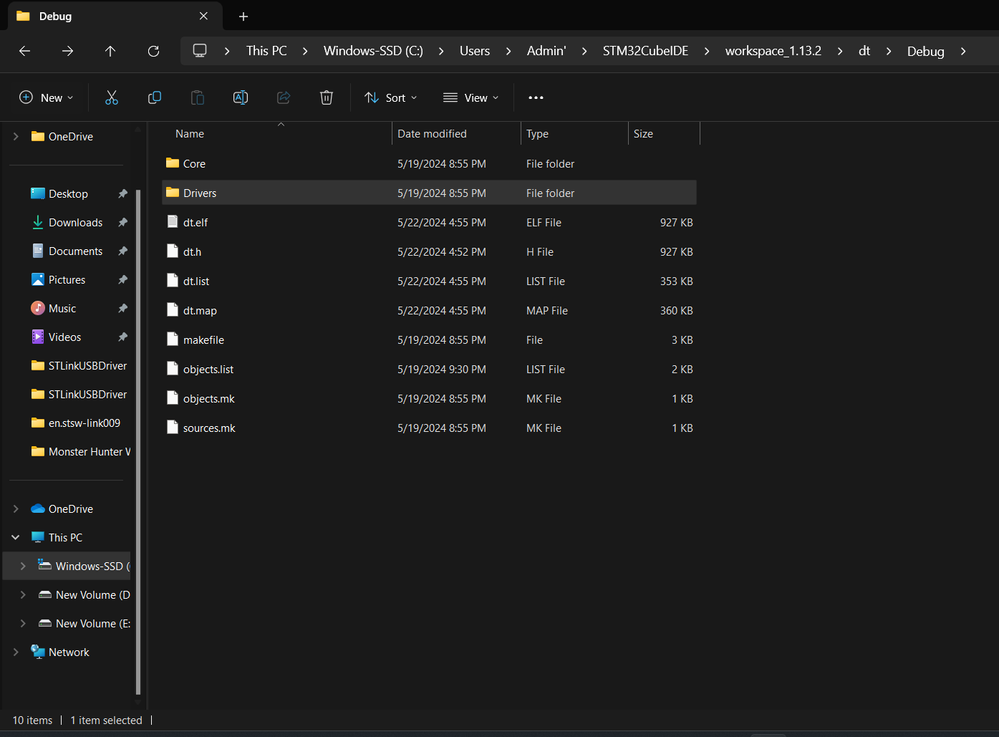

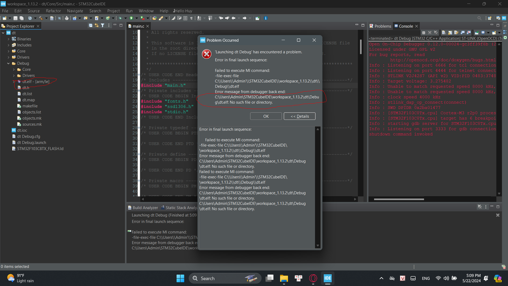

I’m trying to build the tutorial project at https://www.micropeta.com/video43 using STM32CubeIDE , I’ve tried it for the stm32f103c8t6 and it builds without error but when I tried to debug it said that these no such dt.elf file or directory. I have check the workspace and the dt.elf is literally these. I even tried to Inclued the dt.elf manualy but it still didn't work

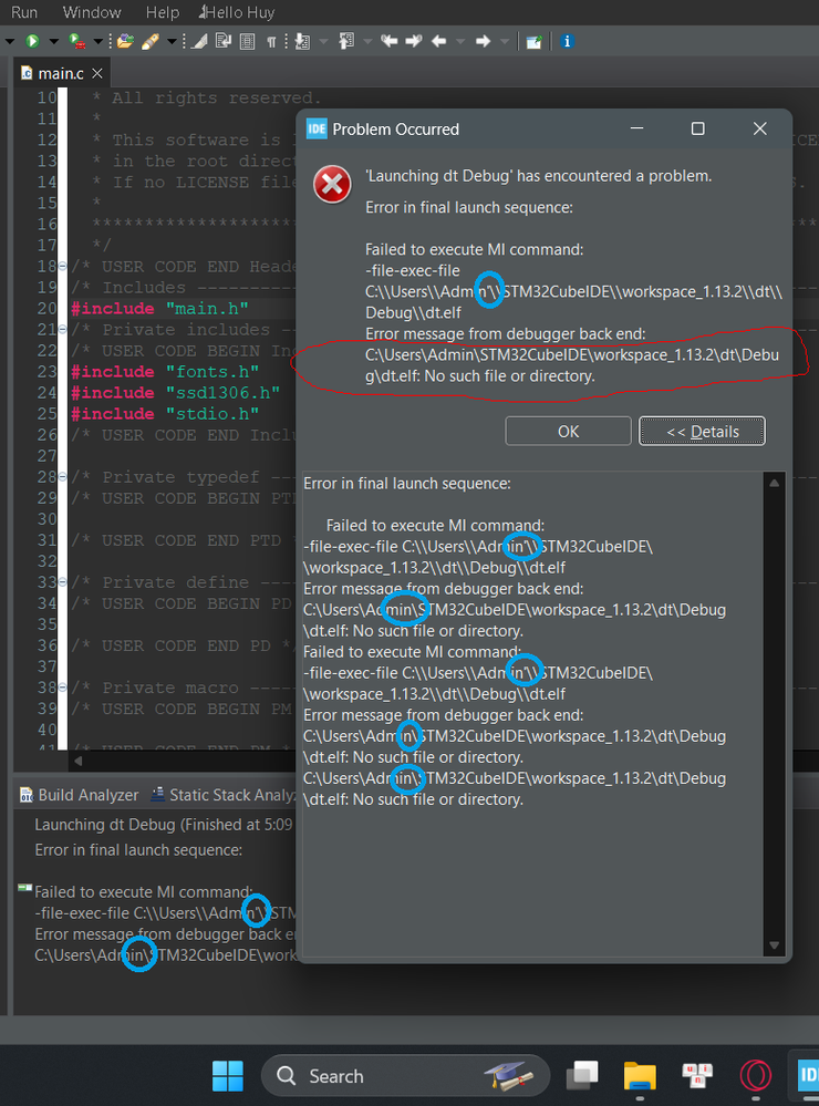

Spaces or special characters in paths can cause issues.
Please remove the single quote from the username or use a different path. I usually put my projects in a folder directly in my root directory to avoid paths that are too long or have spaces.

dt.elf is a binary auto generated by the tool after compilation.
dt.elf needs to be in Debug folder. No need to move it to other location.

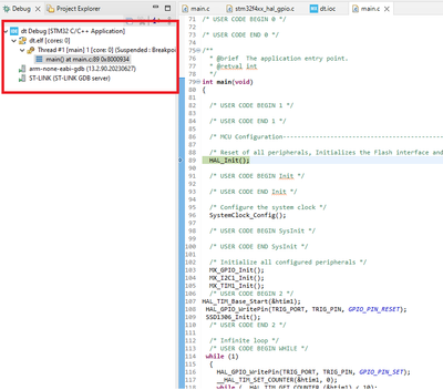

I didn't face any issue to upload and start a debug session with your project:
Could you please regenerate the code and compile again?
