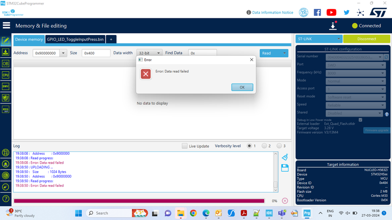

I am using NUCLEO-H563ZI evaluation board and i want to create external flash loader for IS25LP128 QSPI flash memory. I used external loader files from GIT HUB and .stldr file in STCUBE programmer external loader folder location. when i try to read from 0x90000000 location, i am getting read failure error. I used the below path to create external loader for IS25LP128 QSPI flash memory,
Could you please help me to solve the below issue?
