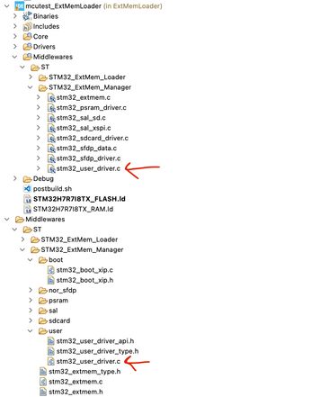

I was snooping around and I found out that I could configure the external memory manager to use user drivers. I have trouble deciding where to put the driver. Should I put it in the stm32_user_driver.c file under the Middlewares folder or under the ExtMem_loader subproject?

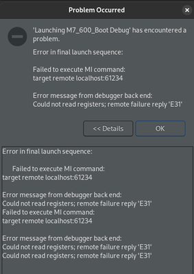

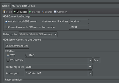

some one of you can program the STM32H7R7I8T6 whit only use the internal flash? (like a normal microcontroler without the external memory) because i need to use this wreat uC whit only the internal flash, but i canot use this, i do know whay, i only have a mensaje and i canot concet to program or debug the STM32H7R7I8T6 whit the stm32cubeIDE and the st-Link/V2 (whit other microcontrolres work very well like the stm32f429, stm32H747bi, in my customiser PCBs, etc)
this is the mesnger that i get whit i tray to program or debug the STM32H7R7I8T6:
and this is the basic debug configuration i use
