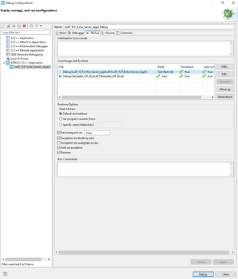

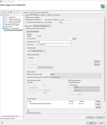

This application runs from the external Flash memory (LwIP_TCP_Echo_Server Appli).
It boots from internal Flash (Template_XIP_Boot) then jumps to the application code in external Flash.
To configure STM32CubeIDE Debug Configuration, you must do the following:
1. Upload the template XIP Boot
Home\STM32Cube\Repository\STM32Cube_FW_H7RS_V1.1.0\Projects\NUCLEO-H7S3L8\Templates\Template_XIP\STM32CubeIDE\Boot
2. Add the adequate external loader in Project->Debugger Configuration
3. Add in the startup the template_XIP_Boot in Project->Debugger Configuration
4. Move up the application in the startup
For more details, I suggest also that you take a look at Readme file.
I will be waiting for your feedback.
Best Regards.

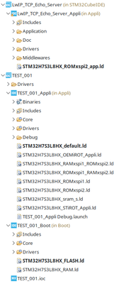

I noticed, that all example projects for H7S3L8 are containing one "sub project" called Appli, while all new projects are containung two sub prjects Appli and Boot. I tried to add the boot project from one new project into an example project, but it doesn't work, or I don't know how.

2025-01-17 5:26 AM - edited 2025-01-17 6:09 AM
Hello @oxc07w2 ,
Best Regards.
Mahmoud

@Mahmoud Ben Romdhane Thank you, now I got it to work.
I read the part "How to use it ?" in the readme file, but didn't understand it, as I'd never had anything to do with splitted code (boot and external) and running code from external memory. Now I know that "template XPI" is an separate example project.
