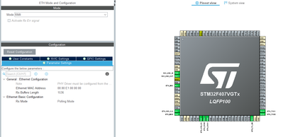

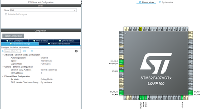

Hi, I have a problem. when I used old cube ide version, ı can changing physical address and ethernet module is to take ip address. But when I use new version I want to edit phy address but this area is not in new version.
That's why I can't use the Ethernet module in the new version.
Can you help me on how to use the Lan8720 Ethernet module in the new version?

Old Version Stm32Cubeide
New Version Stm32cubeide

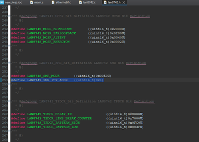

For now, I updated the value of this constant to 0x1 and the module was able to get the IP address. However, when I generate my code with different changes, I need to change the constant again.

I couldn't find any solution other than the one in the screenshot above
