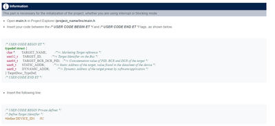

Hello @JRM_02 ,
You need only to add to main.h :
Check this WIKI : Getting started with I3C - stm32mcu
I hope it helps!

Hello @JRM_02 ,
I hope it helps!
Foued
Thank you so much! the WIKI is a LOT a more clear. Appreciate the help!
