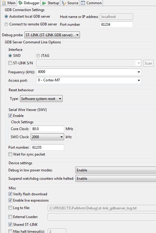

Issue 1: Error checking downloaded code via ST_LINK GDB Server
I choose the reduced speed of the emulator (8 MHz), but the emulator runs at nominal 24 MHz
In log:
ST-LINK SN : 003D00283038511834333935
ST-LINK FW : V3J7M2B4S1
Board : STLINK-V3SET
Voltage : 3.30V
SWD freq : 24000 KHz
Connect mode: Normal
Reset mode : Software reset
Device ID : 0x449
Revision ID : Rev Z
Device name : STM32F74x/STM32F75x
Flash size : 1 MBytes
Device type : MCU
Device CPU : Cortex-M7
Verifying ...
Read progress:
±±±±±±±±±±±±±±±±±±±±±±±±±±±±±±±±±±±±±±±±±±±±±±±±±± 50%
Error: Data mismatch found at address 0x0804F934 (byte = 0x00 instead of 0x4F)
The same error in the flash is found by the ST-LINK Utility when checking memory, that is, it really exists. But when programming through the ST-LINK Utility (same ST-Link, same MCU, same HEX), no errors occurred during rechecking.
I tryed low speeds, by this setting is seems to be ignored.

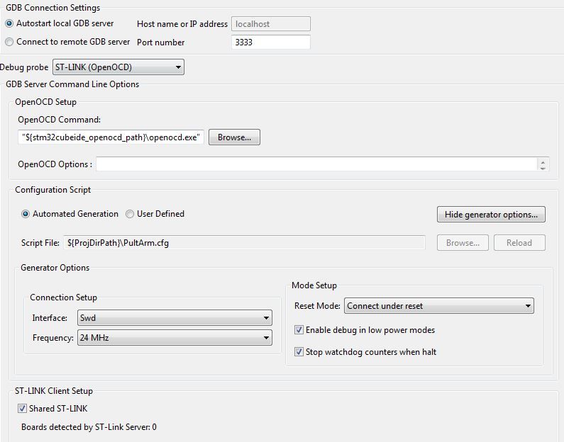

So I tryed second variant: OpenOCD...
Issue 2: SWO Output does not work in OpenOCD
I configured as follows
Successfully connected to the target, loaded and verified the firmware at maximum speed, launched the program, opened the "SWV ITM Data Console", Added port 0 ... And nothing happened. Perhaps I need some additional initialization of OpenOCD, but I haven't found how to do it.
And again - when later connecting to the target through the ST-LINK utility, I see debug output in SWV Viewer (so, there are no problems in code or target).
