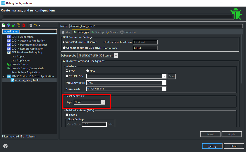

2021-01-13 12:42 AM
Actually there is a simple way to solve this problem:
