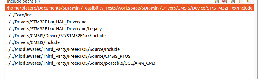

2023-05-18 2:55 AM - edited 2023-11-20 5:09 AM
Thank you for your swift response.
But it does not work.
The files are in the filesystem, but for some reason I had to give an absolute path to the IDE. Below are my current PATHS:
The problematic header file is in that directory.
