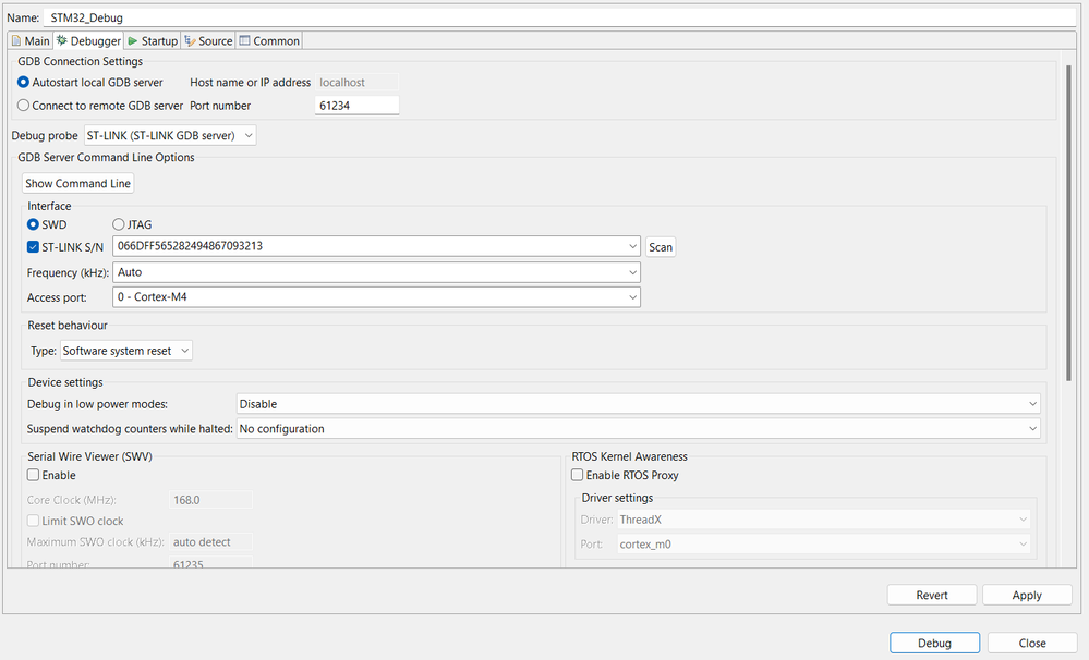

Hello @MA and welcome to the community,
Could you, please, provide the debug configuration for this board and attach the GDB server log file to further analyze the issue.

2023-08-16 4:51 AM
Hello Sir/Madam,
Yes , I have tried with the version 1.12.1.
2023-08-16 5:02 AM
2023-08-21 3:29 AM
Could you connect the target to STM32CubeProgrammer . If it is connected successfully , try to:
- Erase the Flash with STM32CubeProgrammer
- Disconnect STM32CubeProgrammer from the target
- Debug the program using ST-LINK_gdbserver
