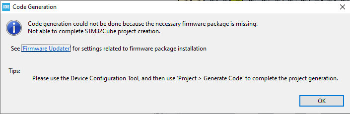

I downloaded STM32CubeIDE and went to create a new STM32 Project. I selected my dev board and the firmware files automatically downloaded and unzipped. I then accepted all the default settings, however the error "Code generation could not be done because the necessary firmware package is missing. Not able to complete STM32Cube project creation." was thrown (and is thrown every time I try).

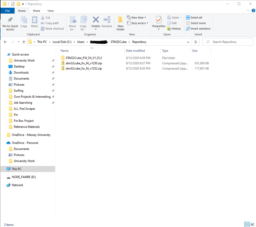

I have tried re-downloading the firmware files (which is painful due to having a very slow and expensive connection because of where I live, hence the desire for offline) and tried suggestions like this: https://community.st.com/s/question/0D53W00000NzOxxSAF/errors-in-stm32cubeide-firmware-update-offline with no success.

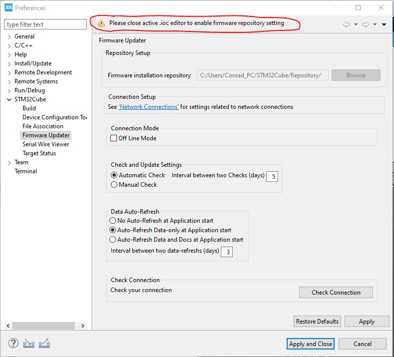

I also do not know what files I actually need, what the error in the second image means or how to fix it, and what I need to do to fix the firmware repository settings.

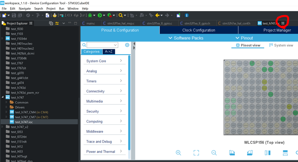

To close the IOC file, go to the main window and click the "X" in the tab that shows the IOC file open.
You can also access the updater in Help -> Check for Updates and Help -> Manage Embedded Software Packages. These updaters work for me.

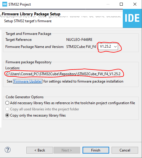

I ran all the updaters in the Help menu I could. I also noticed that when creating a new STM32 Project when I went 'next' I could change the search location for the Firmware Installation Repository, is this the correct location?? It was originally somewhere else (seemingly a random unrelated place), however I cannot remember where woops!!
