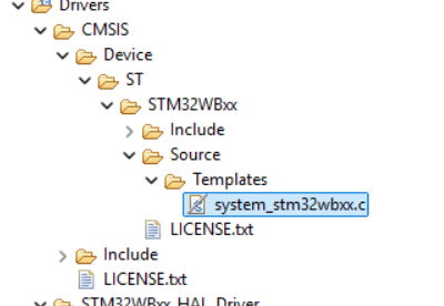

I've got a project that has the following files in the tree view:
All is well if I clean and build, but if I open the .ioc and "Generate Code", the tree changes to:
and the project then fails to build due to a duplicate system_stm32g0xx.c file.

I am also facing the same issue. I just excluded the file from the build, and it worked for me.
