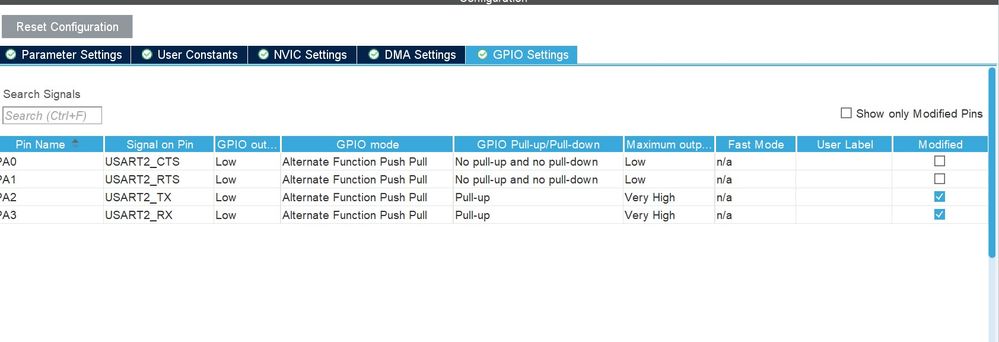

I am using USART2 in DMA mode for Tx/Rx. I have attached the USART configuration after enabling HW flow control CTS/RTS. Are the configurations corrrect or do I have to modify anything?

I've been doing this for a while, and I don't recall XON/XOFF being done with HW
The HW flow-control on the STM32 side needs a lot of help, I'm not even convinced it works properly or effectively, as the STM32 generally only have a single byte of buffering, and flow-control really needs a more long term understanding of the buffering than a bang-bang strategy.
Generally implement protocols that have flow control in mind.
Have buffers deep enough that you can manage things.
When dealing with modems, pay attention to the CTS/RTS DTR/DSR signals more directly and don't cram down data when the devices say they are busy.
