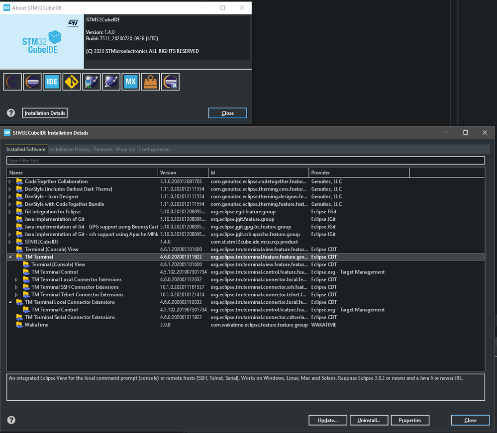

2020-05-30 9:36 AM
I tried this and it just broke my STM32CubeIDE.
I think the culprit may be this->"Unresolved requirement: Require-Bundle: org.eclipse.team.core; bundle-version="[3.6.0,4.0.0)"
I am really not interested to spend hours and hours to debug this, just to get the terminal working like it should. I have code to write. I attached the log, if any kind person or mayde ST (not getting my hopes up) could fix this in the future. Posted just to let others know, so they don't have to waste their time trying this and ending eihgter re-installing or spending hours finding the solution.
2020-06-02 12:44 AM
I found this topic because I also wanted to have terminal window inside the IDE.
For me it works as it should. Here is my way of installing this feature:

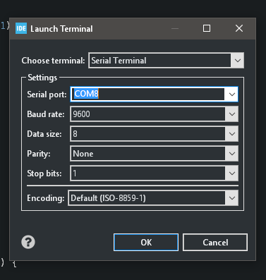

2020-12-01 10:41 AM
I installed Tm Terminal throw the help menu/Eclipse Marketplace. I didn't have any error on the installation but when I choose Serial Terminal, no port appear the the settings. I've tied with Tera Term and it had no problem detecting the nucleo board.
Any clue?
Bruno

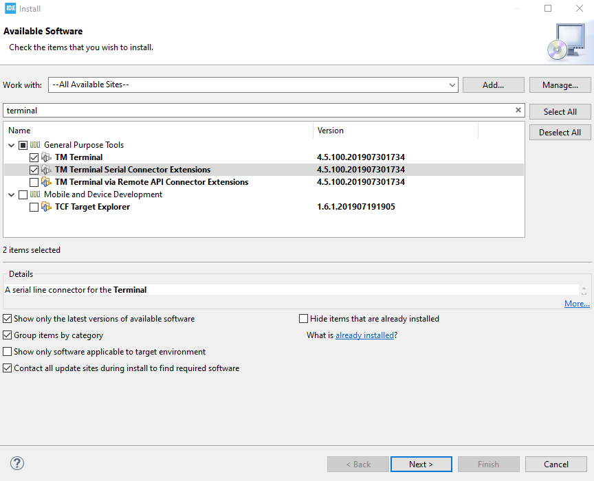

2020-12-02 12:28 AM
Hi Bruno,
Did you install also "TM Terminal Serial Extensions"?
Leszek

2021-02-16 6:01 AM
https://www.eclipse.org/setups/marketplace/?id=1687099
https://download.eclipse.org/tools/cdt/releases/9.11
help>install new software
When installing, it prompts you to immediately update, do not do this.IDE Version 1.2 1.3 1.4
version 1.51 no check,
on 1.5.1 crash is possible, check in the sandbox.
