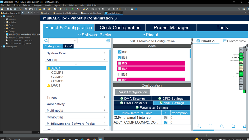

hello..., I'm having a little trouble, is it for the icon or display on the stm32 cube idea in the ioc settings section can be enlarged or reduced. as we can see in the picture, I think the display is too big and quite disturbing the view, thank you.

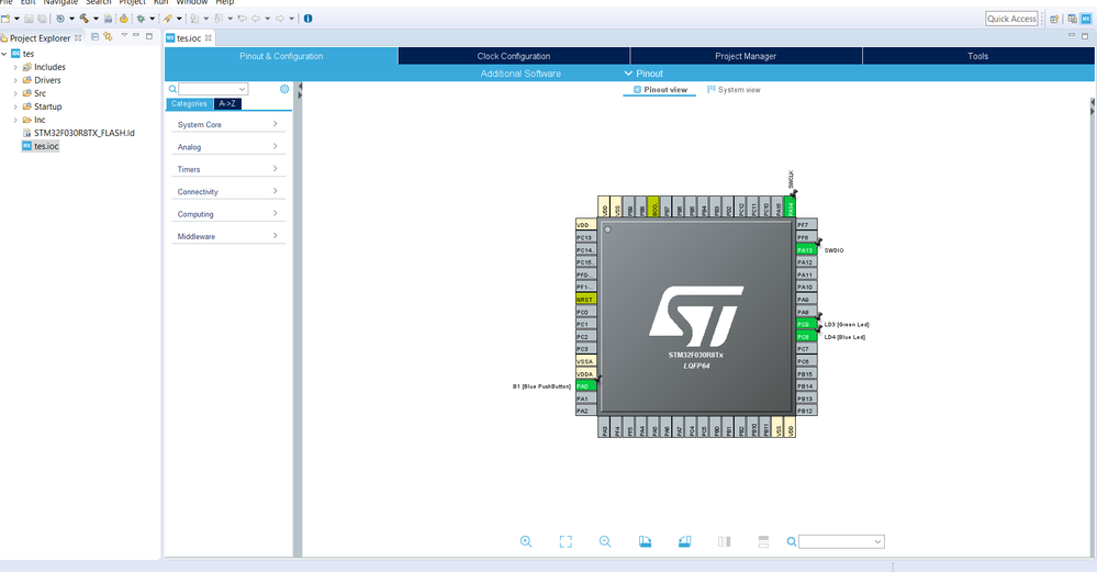

well before thank you for your answer, what I mean is that you can look at this chart, you can see that the icon icon settings in ioc have different sizes, the small size is the cube idea version 1.0.0 and the icon size that tends to be large is in version 1.14.1, I am quite disturbed by the size of the icon icon icon is quite large, is there any way to shrink it, thank you.

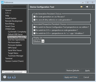

You could try:
menu->preferences->Dev.conf.tool->display size
