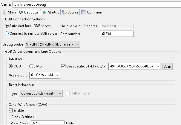

I'm using STM32CubeIDE and Keil uVision5 but i dont know how to select the system boot mode
this is how i'm configurating the debug settings.
