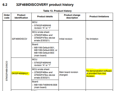

For the new STM32F469I-DISCO board (i.e. 32F469IDISCOVERY), version DK32F469I$AU1, is the demo source code available anywhere in a STM32CubeIDE supported project or IOC? So, someway to compile and test/debug the complete demo in STM32CubeIDE?
ST.com webpage for STM32F469I-DISCO only shows compiled demo and the STM32CubeF4.
But, STM32CubeF4 doesn't contain any STM32CubeIDE compatible projects (?) It'll be excellent if new STM32CubeF4 update is provided that contains STM32CubeIDE projects.

No demonstration software is provided from 32F469IDISCOVERY, version DK32F469I$AU1. Please refer to UM1932.

It's very disappointing that no demo software is available for 32F469IDISCOVERY version DK32F469I$AU1. Unless ones looks in UM1932 closely, it's not obvious from the 32F469IDISCOVERY webpage. On the webpage, "you might also like" points to STM32CubeF4. But you have said F4 demo wont work for this rev of board (i.e. no demo software is available, even what is in F4). Another point is the compiled demo binary is also available on the 32F469IDISCOVERY webpage under tools & software (32F469IDiscovery tools-software) . It doesnt mention not being compatible with new rev boards.
