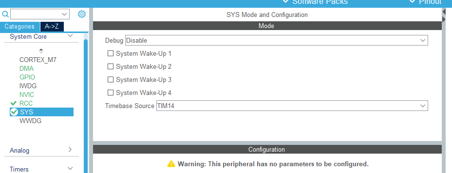

I am not sure but I think I shouldn't freeze TIM14 even in debug mode because I have it configured for FreeRTOS like this:
