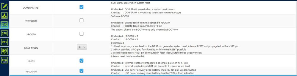

Hello @Community member and welcome to the Community :)
Check the optional bytes, and BOOT0 pin.
The option can be found in STM32CubeProgrammer -> Option bytes -> User Configuration
Check also in the AN2606, bootloader activation pattern for for STM32G491.

2022-09-13 3:45 AM
Hello Imen,
thank you for your reply.
We use PB8/BOOT0 as I²C-SCL - so there is an pull-up of 4k7 ohms connected.
The AN I will at later.
Rahul
2022-09-13 5:47 AM
Check if BOOT0 is pulled low.
