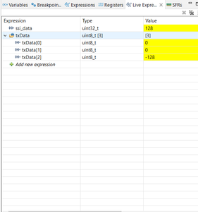

Hello guys,
I have a problem like this. How can I fix this problem

Yellow color marks values that changed since last read by the debugger, for example after doing a step or hitting a breakpoint.

Do you mean you get a negative value for an unsigned variable?

Yes,I got negative value from unsigned varible. How can I fix ?

The debugger interprets uint8 data as int8

When you created the project, did you change anything in the properties? What version STM32CubeIDE ?

The configurations are all the same and works properly in Keil.
