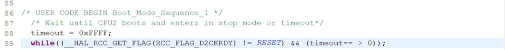

However, when debugging, it runs to this line and cannot exit.

my problem lies in the fact that it cannot escape while((__HAL_RCC_GET_FLAG(RCC_FLAG_D2CKRDY) != RESET) && (timeout-- > 0));
I looked at your suggestion but none of the solutions worked.
Thanks

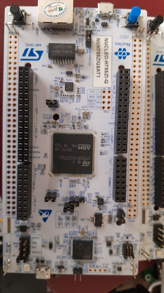

2024-07-20 2:48 AM - edited 2024-07-20 3:21 AM
I run it on AT1 board with no problem.
But running on AT3 board, I get this error. Is there any difference between the two nucleo boards H755 AT1 and AT3?
NUH755ZIQ$AT3
NUH755ZIQ$AT1
