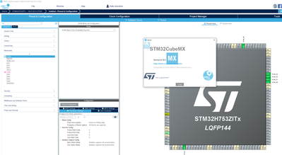

It seems there is a bug on the latest revision CubeIDE (1.15.1) to use the DCMI function. The DCMI is able to active on the board Nucleo-H743ZI2 or Nucleo-H753ZI with STM32CubeIDE (1.14.1). But today, when I installed the latest revision (1.15.1), the it shows DCMI is an exclusive choice. As shown below, there is no pin conflict as all the pins have not been set up. Thx.

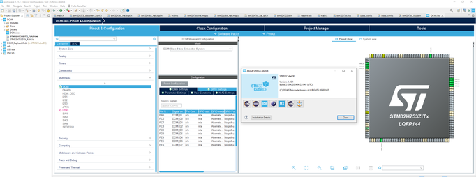

p.s. No issue on STM32CubeIDE 1.14.1. See below.

I'm not able to reproduce the issue using STM32CubeIDE 1.15.1  version as shown in the below figure.
Could you please try with latest versions of STM32CubeMX 6.12.0 or STM32CubeIDE 1.16.0 and let me know if the issue is solved or not?
