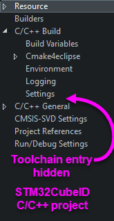

If I remember correctly, the only thing which seemed to prevent the use of the cmake4eclipse plugin was the STM32CubeIDE project type forcefully hiding the Toolchain entry under project settings > C/C++ Build. If you do allow us to add/modify toolchains, this might automatically unlock the use of this CMake pluging – which would be a massive win for your editor!
