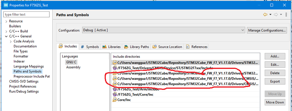

Window->Preferences->STM32Cube->Firmware Updater...
2023-04-13 7:55 PM
Hello @GWang.6 ,
In STM32CubeIDE, look at the menu bar at the top, and go to Window, Preferences, STM32Cube, Firmware Updater. In the upper portion of the window you should find a field named Firmware installation repository.
